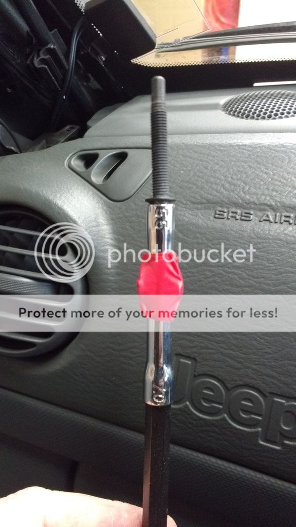

Didn't have a 5.5mm socket but found in my collection of R\C stuff a combination X spanner with 5.5mm on 1 end, 7mm on the opposite. Chopped off the other 2 arms for clearance and attach it to a 7mm Allen key, hey presto a dedicated grab handle removal tool :D

PostPosted: Sun Jan 10, 2016 9:02 am
Joined: Sun Dec 29, 2013 10:23 am
Posts: 96
Location: Malpas, UK
