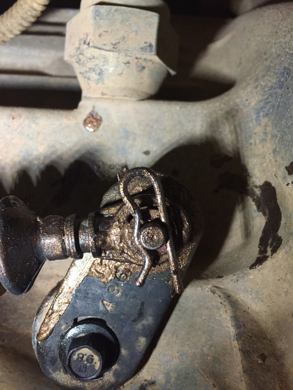

 Post subject: Re: transfer case not fully engaging
PostPosted: Sat Dec 22, 2018 12:18 am
Posts: 7381
I made a metal bushing to replace the plastic one and held it on with a spring washer and a small hitch pin. see picture.
[url=https://postimg.cc/k26DfQZm]Image
PostPosted: Sat Dec 22, 2018 11:08 am
Posts: 7381
Picture of installed metal bushing, washer, and clip with lots of copper anti-seize for lubricant:
