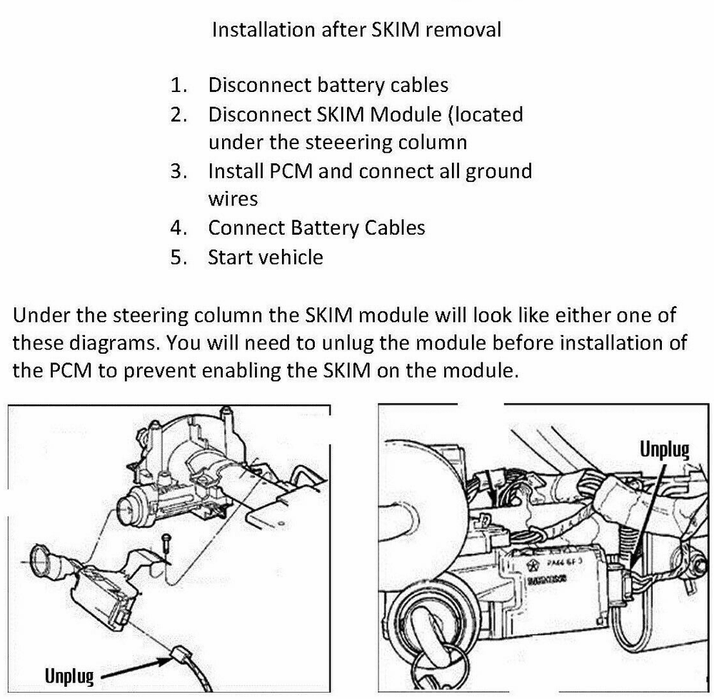

Anyone know anything about the SKIM? WTF is the SKIM module and what does it do? It really sounds similar to the problem I've been having.
No Crank - YES
Turns off after a few seconds - Doesn't happen to me
Security Light Turns on - Doesn't happen to me
Locking and Unlocking issues - YES sometimes
Key in the ignition does not turn - Doesn't happen to me
https://www.youtube.com/watch?v=jvG2xubQXj8

There were a couple more items to check = TPM could cause a no crank problem but I was getting more than 12V and the SKIM = key immobilizer. Not sure how to test this one.
