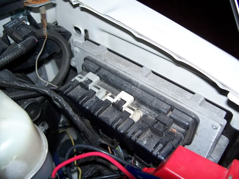

The JTEC controllers have three connectors and the NGC controllers have four.

JTEC it is. That would make things better for me correct? Because that would mean i could use JTEC or NGC since the JTEC is standard and the NGC is newer.
"It's not stuck...it just doesn't want to move on its own..."
Silver 2002 Grand Cherokee Overland (Not running as of 12/30/2014. Suspect dropped valve seat)
White 2003 Liberty Limited (RIP)
L.O.S.T. #: DV053827
PostPosted: Sat Feb 24, 2007 11:57 pm
Posts: 1195

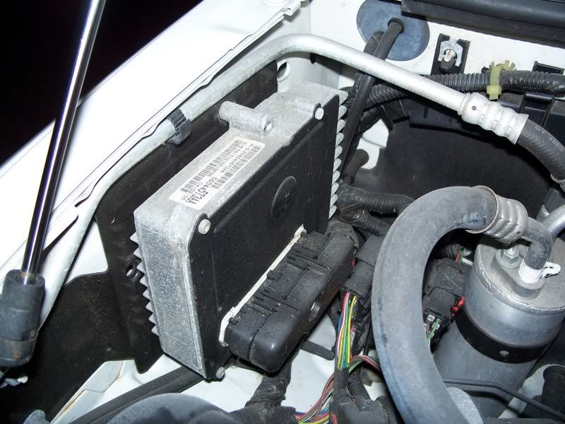

Check to see if you have a seperate TCM on the other side. If you do, you have the 45RFE. That is good for going with the 4.7. With a torque converter and shift kit, it should be able to handle the 500 hp too.

Well fellas, i guess this makes me one luck man. Looks like i've got the JTEC and the 45RFE. I was planning on a shift kit anyway, so i guess i'll just go ahead with that. I want the $105 kit from B&G Chrysler right? And would that be something i could install myself, i like to think i'm pretty good with my hands, i just don't work on cars too much. I just haven't had the opportunity. So i work on R/C cars insted :lol:
Tell me if these are the controllers i think they are...
JTEC Controller:
45RFE Controller:

You can do a happy dance. :D
You'll want the Transgo 45RFE-HD2 Reprogramming Kit and an APS torque converter, along with programming from B&G. Here's a link to the instructions on installing the shift kit.
http://www.apsprecision.com/45RFE%20Shift%20Kit/45_545RFE%20Instructions.pdf
