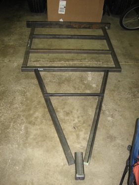

I laid out all the frame pieces to see how it would look. The length of the A-Frame tongue will allow me to open the tire carrier and tailgate on the Rubicon with nothing on the tongue. With something loaded on the tongue it should still open enough to get something in and out. It's not as if there is much usable space behind the seat anyhow. I normally just keep tools and the winch gear back there:

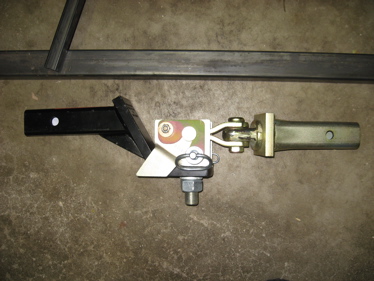

Here's an updated picture of the lock and roll hitch setup. I bought a 4" drop hitch bar from good old Harbor Freight today to complete the setup.

for added strength wouldnt you want the drawbar setup to run back to the main box frame

I plan to gusset it to give the same effect without having to notch the tubing on the front crossmember and weaken it. I just don't have those pieces cut to size at this point.

you dont notch the RHS box section
you lay the triagular drawbar setup on top of the frame of the trailer ( so when the frame and axle is welded and mounted you flip it over and the drawbar setup is hidden away and it transfers the stresses of the load on the drawbar through to the box trailer frame

I' ve explored a lot of those ideas and I think I can manage the same effect, but have all my steel on the same plane with my idea. basicaly it will look like this:
I may also reinforce by stretching a strip of steel across the front crossmember to link the angled pieces together.

Got the rolling chassis complete tonight. It was too dark to take a pic of it hooked up to the Jeep, but here it is in the garage:

Looks Great!!! A small gussett on every interior angle would really do the trick...14 in all...12 inside the "box" and two larger ones inside the tongue. If you bevel both edges of the gussets that are to be welded, you will get more surface contact too. I guess you could add one more in the beggining of the tongue too.

Already ahead of you. That's the first order of business next time we work on it, along with boxing in the ends of the bumper and draw bar.

When available please post pics of how this pintle-hook set up looks.
