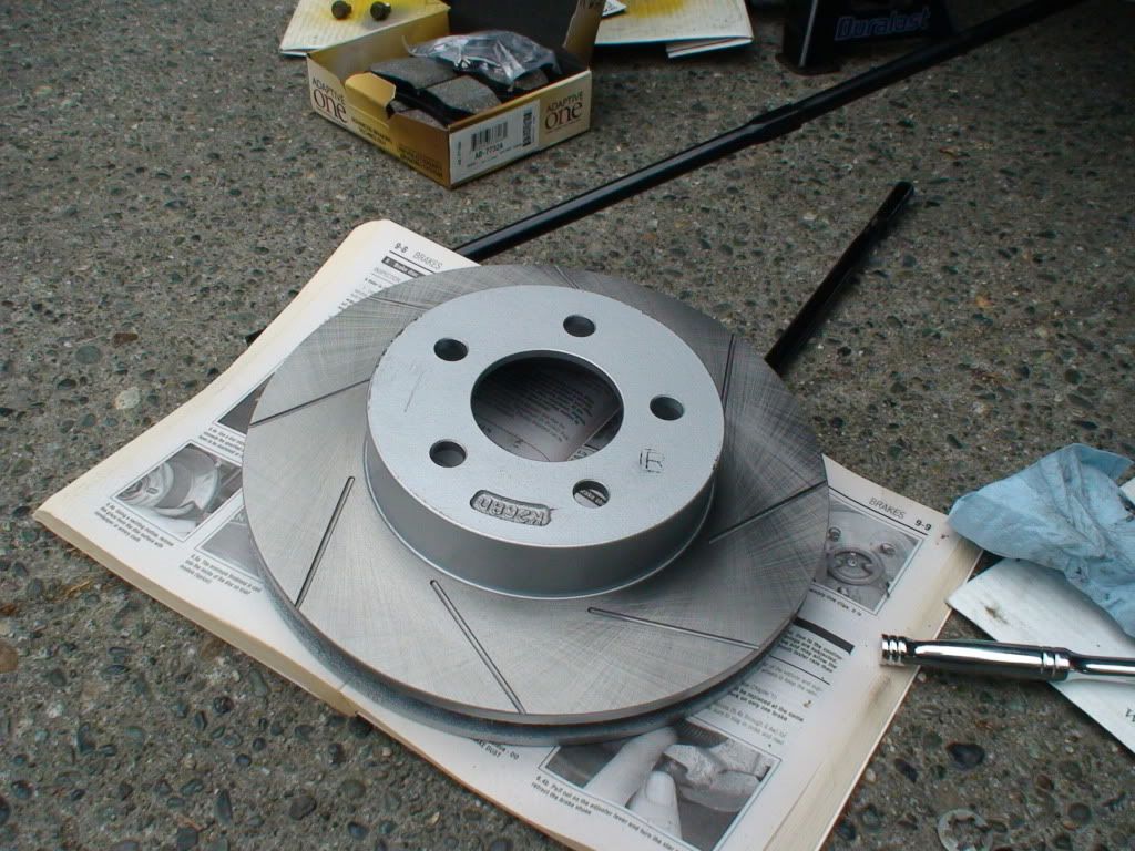

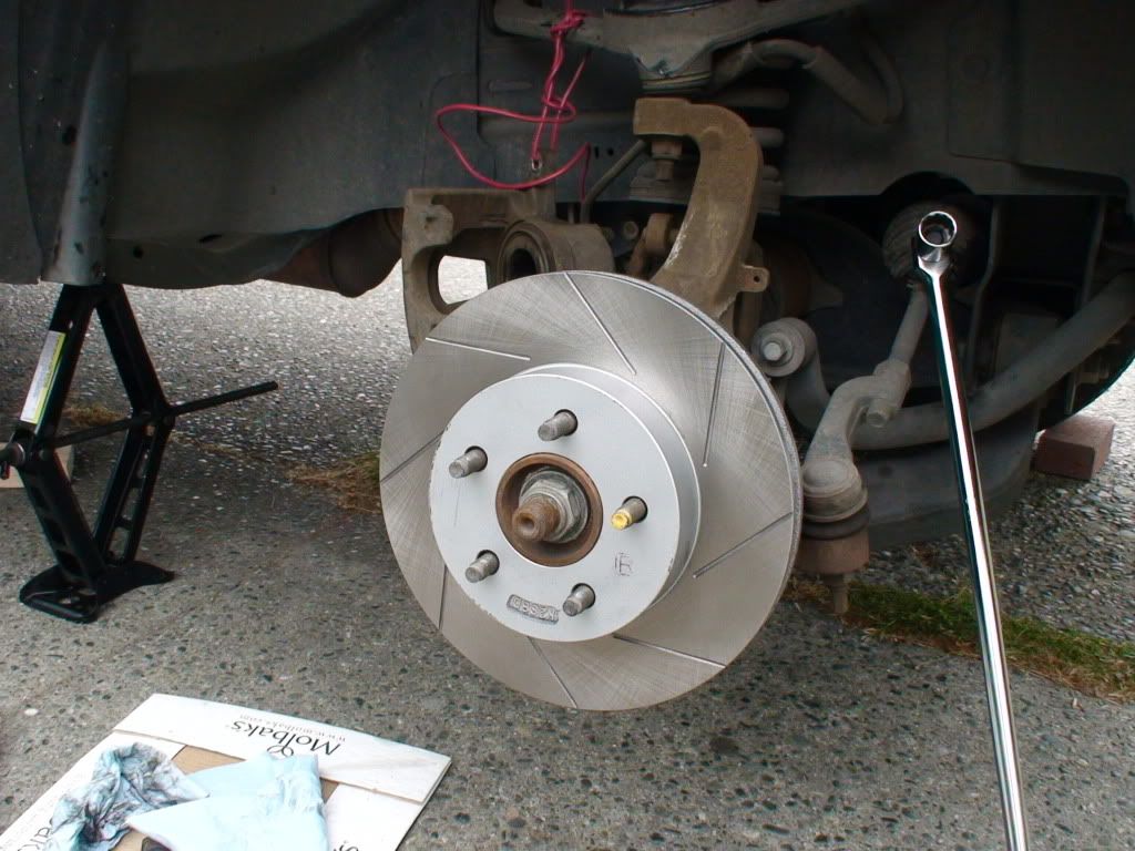

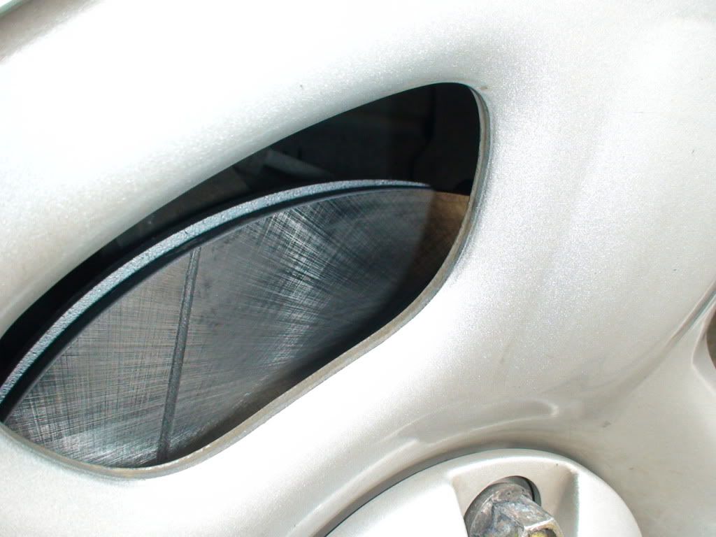

Just put in my Powerslots and Adaptive one Ceramics:
