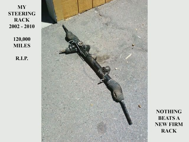

Well here it is about 7000 miles later and I started to notice a bit more play in the steering. So I pulled the skid, removed the rack bolt and rubber washers I had installed way back when. Here they are:
The top rubber washers were in pretty good shape. You can see however that the upper steel washer was starting to punch it's way through, though.

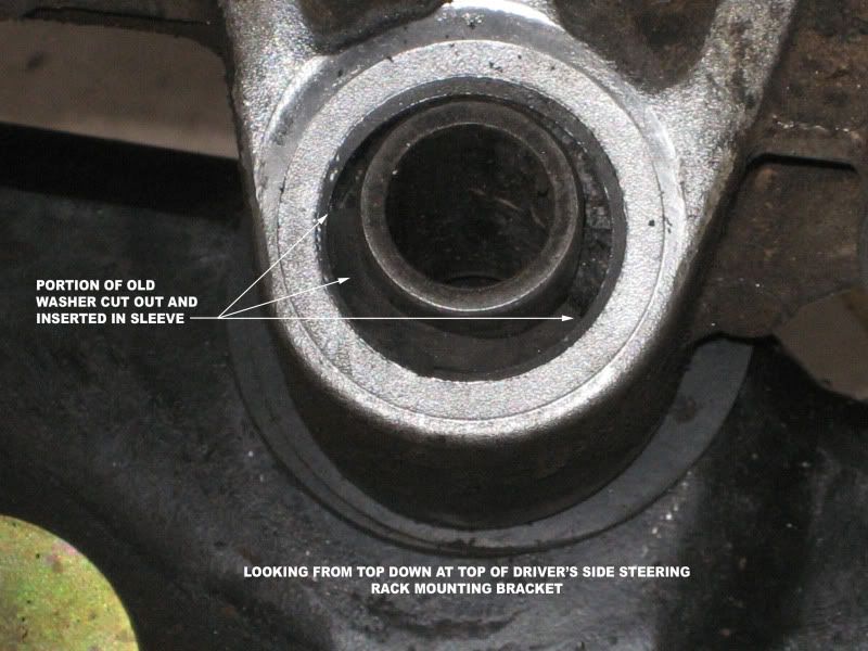

The bottom washers were toast however. I took this pic after I sliced a chunk off one of them to use to pack the bolt sleeve. When removing the bottom washer I used some plyers and split the washer. It was still intact beforehand. As you can see both are cupped from the stress. Also the rubber on both the lowers was deteriorating on the inner faces - probably due to oil residue and the repeated cycles of movement and contact with the steel sleeve.
As mentioned I packed some rubber in the sleeve to firm it up. The rubber in the sleeve is disappearing more and more.
I installed four new rubber washers and tightened everything back up. Viola! Band-aid numero dos is up and running.
