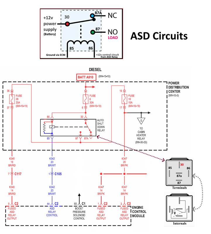

Please humour me on this next suggestion, you may have done this, but I have re-read your posts and cannot be sure. The following was the "eureka moment" for my CRD troubles.
Pull the ASD relay from it's socket. Place a jumper between 30 and 87 in the socket. This by-passes the ASD relay. Does it turn over and start? I know you said the ASD relay clicks, but I could find no verification of continuity through the contacts in your posts. if it does start, you have a faulty ASD relay. This was exactly my issue. The contacts were burned in the ASD relay. Replacement cured the issue.
Good luck from the other side of the pond!

That certainly is a good test,
but keep in mind, if it spins over and starts using the jumpered pins method you suggested, this could also be telling you the ECM is not satisfied with one of the many inputs it receives at to activate (ground/energize) the ASD relay.
Hopefully he has already checked the main power feed fuse to the ASD relay along with the several fuses that get power once the ASD relay is energized.
With the ASD relay unplugged and testing it's connections with a 12v test light or multimeter, he should have 12v at terminals 30 & 86 (key on or off) and a ground at terminal 85 (key on).
He could also simply try swapping the ASD relay with one of the other relays of the same size and see if it spins over and starts. This would test the relay itself if the ECM is providing the ground for the relay.
Low & High speed fan relays, or the blower motor relay.

Afternoon guys, yes I did swap over the relays and yes I did tests with multimeter and it was spot on correct, I also jumped 30 and 87 pins but stil nothing happend except a buzzing somewhere in the engine bay. Thanks

Terminal 86 at starter relay is 12v positive (HOT) through fuse #28. Earth grounding this terminal would blow fuse 28.
You probably meant you earth grounded terminal 85, which would be correct as that is the circuit that the ECM grounds to engage the starter relay.
If the ASD relay is chattering, I would swap it with one of the other relays of the same size like the blower motor relay.
Also check the supply voltages at the ASD relay on terminals 30 & 86, they both should have 12v battery voltage showing.
Check for a ground with Ign. switch in the ON position, on terminal 85 at the ASD relay. The ECM should be grounding the ASD relay if all requirements are met.

Hi, I meant 85 yes, fises are all good, ASD relay dont make a noise, it just engages with one click, I did swop it around with other relay. All the voltages on ASD relay are in spec like the manual described. What I did find on the ECM if you open it and hold the pc board in your hand, with vehicle switched on, one corner of the board starts to heat up while the rest of the board are cold.
