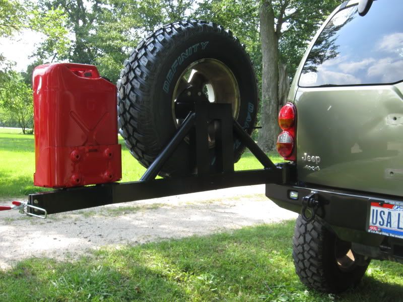

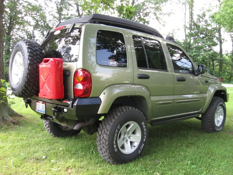

Here are some pictures of the first prototype installed on Matt's KJ. We still owe him a few little things and we've still got a lot of work to do to make it viable cost wise. I've got plans for cost savings that should get us into these ranges cost wise:
Basic bumper: $750-$950
Swing Arm with tire carrier: $250-$350
High Lift mount: $65ish
Jerrycan Mount: $65ish (works with Blitz can & holder, appx $70, not included)
Light bezels and mount: $125-$175. Only work with PIAA 1400's (approx. $180, not included)
Integrated Hitch: $200-$350
Total fully loaded: $1455-$1955
Shipping is estimated to be $100-$250, depending on location and option level.
I know it is a wide range, but it is just an estimate for now, to allow some of you that have expressed interest to do some planning. I'm currently working on the design nightly to refine it and make it more economical, but it will look and function the same as his prototype. Once I have the design refined, I'll make a 2nd bumper, time everything, and come up with final pricing. I'd be willing to sell the 2nd bumper (money talks) but currently it is slated to go onto my Jeep.

 Post subject: Re: Boiler's Rear Bumper Build - Prototype #1 installed pg 4
PostPosted: Thu Jun 24, 2010 1:25 pm
Posts: 2079
Location: Bethpage, NY
now make one for the KK :wink:
PostPosted: Thu Jun 24, 2010 2:21 pm
Posts: 2121
Location: Kentucky, USA
:shock: HOLY crap...that is the most awesome looking KJ EVER.
PostPosted: Thu Jun 24, 2010 8:05 pm
JACKRABBIT
JACKRABBIT
Posts: 3970
paint the arb black now!!!! amazing looking!
PostPosted: Thu Jun 24, 2010 8:07 pm
Posts: 2121
That's the Cactus Green, isn't it? I looked at one of those on the dealers lot back in '04. I always did like the "unique" colors on a Jeep. Man...that is sharp. :JEEPIN:
So anyway, yeh that rear bumper looks fantastic and I would possibly be interested. Well, I would DEFINITELY be interested...it's just a matter of coming up with several hundred dollars for something that the wife says I don't "need". :roll:
