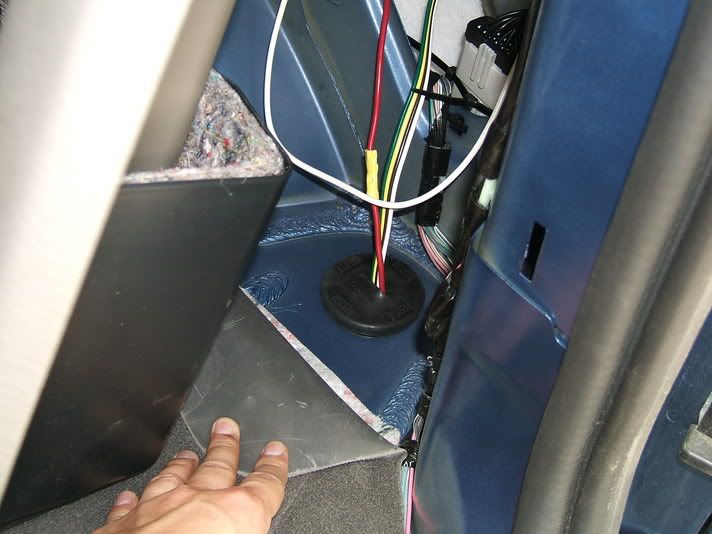

So I just picked up one of those $17 u-haul wire-it-yourself jobbies, and it seems to be working fine. I routed the wires through the hole in the back of the taillight into the area behind the panels in the back. Now I just need to get that 4-pin connector out the bottom and mount it up under the receiver.
There is a little 1.25" x 2.0" hole that looks very much like it is meant to be popped out just for this purpose. It even has little tabs in the bottom. It doesn't just pull out though, it looks like it's either welded on, glued on, or maybe just held on with a layer of paint. Any suggestions on popping that bugger out? (or maybe some of you ran the wire a different way?)

Here is the hole where the wires go out. :wink:

So that is on the passenger side? Did you already have that rubber grommet there?
I have to route the wires for mine down the drivers side, since that is how the box is wired (short leads leading to the left lights, one long lead over to the right).
Photos Cardomain
PostPosted: Mon Nov 20, 2006 6:38 pm
Yea, thats passenger side. Grommet was already there. Couldnt you just switch it? Put the long wire coming from the left and short wire from the right? I guess if you already have it wired that would be a big hassle.
