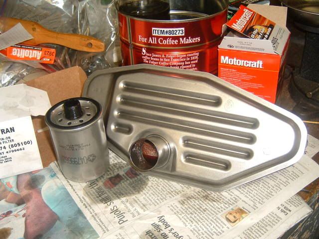

For what it's worth, here are the filters.
I don't remember how I got the little filter out. It may be smaller than your oil filter wrenches accommodate. I may have grabbed it with a large channellocks.
EDIT : YES... As pointed out. These are from the 45RFE Transmission. The drawing in the Parts Manual for that other one shows a large, square filter.
Does the other transmission HAVE two filters ?

Are those filters on the 45RFE or 42RLE?

Those are for the 45RFE.

PostPosted: Thu Nov 02, 2006 12:35 pm
Posts: 1214
42RLE only has one filter.

Hmm. Thanks for the pic eddo! I know what kinda filter to look for now.. :wink: They always seem to give us the wrong one.. Then when your right in the middle of a puddle of oil, you find out you have the wrong filter.. :?
