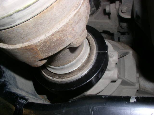

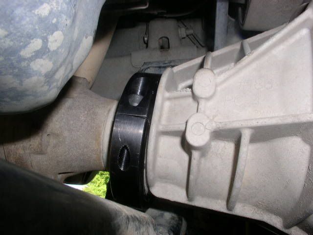

Fulltimer wrote:
Does anyone remember where that picture is of the broken housing?
Wham!
And here are some with the collar installed. I should be getting mine in a two weeks of so.
L.O.S.T. Member 2877
