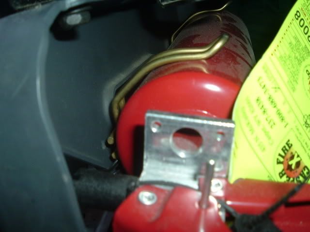

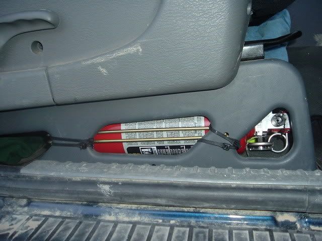

I finally got around to mounting mine the other day. Just took pics of the install, tonight.
I tried for the driver's seat but the power unit wouldn't allow it to fit. It's pretty easy to reach from the driver's seat or even standing on the ground, dr side, if you're a little taller than me.
