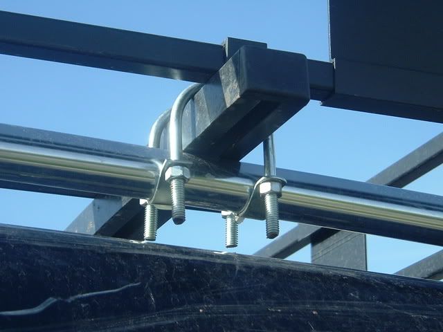

Nothing special holding mine on. I just went to ACE and picked up 8 U-bolts and used the bottom rails on the Surco to mount to the rails on the KJ. When I first started assembling the Surco rack, I had my doubts but, it's a lot stronger than it seems, once you get it all together.

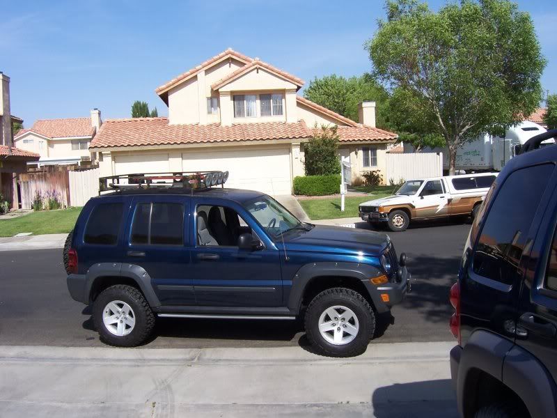

I have a confer rack with custom mounting brackets that fit in the stock KJ roof rail holes. Not sure how much you're looking to spend, but if you're interested contact All J's. They buy the racks, then fab up the mounts. I don't know the price for a new one since I bought mine used from Wally.

do the u-bolts bolt into the stock bolt locations on the roof or do they connect the stock roof rails to the surco? pics?

I have a Garvin Wilderness rack w/light tabs for sale... I loved it, it is not as tall as the Conferr, and mounts directly to the factory roof rails. I took it off because my roof rails broke off the roof because I overloaded the rack multiple times and wheeled a bit hard. Just remember, regardless of what the rack manufacturer says, follow the weight limilts in your owners manual.

This is how I did mine. I need to get some more nuts (no wisecracks!) and trim the excess bolt length. Those flats came as flats and they don't seem all that strong so I'm still looking to pick up the Surco mounts, eventually but, so far It's stayed right where I mounted it and I've used it a fair amount for the short time it's been on there. I can shake the whole Jeep around by the rack, as much as the stiffer shocks and struts will let me anyway.
