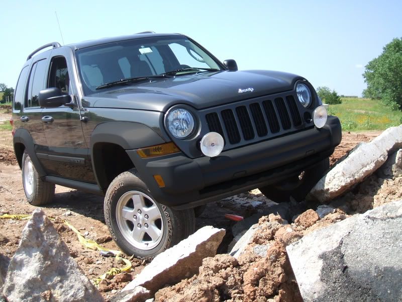

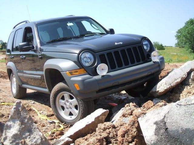

After TJKJ's inspiration and a few others I've really been intriqued by doing this I just don't know what I think.
So after a quick photoshop what does everyone think?
or
obviously without the reflection but I didn't feel like spending that much time on it.
I just don't know if I'll like how it will turn out and if it doesn't turn out good I'll never hear the end of it.
Alright guys convince me! :twisted:
-Gavin

I think it looks good and offers good protection.
PostPosted: Sun Jul 08, 2007 2:07 pm
Sorry to say you can't use spray-on bedliner on the textured gray bumbers/flares,it won't stick.You need the smooth paintable bumbers/flares.It'll stick but flack off soon afterwards just wasting your money,sorry.Both Rhino lner and Line-X need a paint(or primer) surface that has been scuffed with 80-120 grit sandpaper to stick,It won't stick to bare metal or bare plastic.My KJ is a limited so it came with painted bumbers/flares in which I scuffed with 80 grit scotch-brite and then sprayed the bedliner on.

PostPosted: Sun Jul 08, 2007 2:39 pm
Tell that to allyrand. His sport flares and bumpers are holding up fine after rhino-lining. The shop that did them used a special primer on them and then rhino-lined them. They have been done for going on 3 years now.

PostPosted: Sun Jul 08, 2007 5:11 pm
JJsKJ wrote:
Yep,you have to use a primer(with lots of adhesion promoter) first,it won't stick to bare plastic as I stated already.Preping and primering will increase to cost alot.
PostPosted: Sun Jul 08, 2007 11:25 pm
You had better (real time) look at a rhino/Line-X'd vehicle first before doing it. It won't look anything like the picture.
