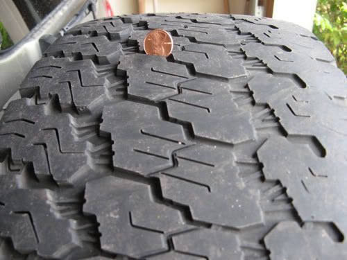

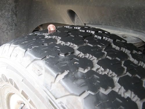

The two front tires now look like this:
My thinking is that the jeep dealership did something while replacing the LBJ that messed up my front alignment. I know there has been some debate on these forums if a realignment is part of the LBJ recall. Tech at Rusty's thinks that is where the problem was. Tech at Goodyear says they really could not say without knowing how jeep did the LBJ recall. I am going to contact the jeep dealership today with these facts to see if they will credit me some of the value of the tires. Depending on how that goes, I may also contact the DaimlerChrysler Company people. My fear is they will say, you have a lift so we owe you nothing. My plan is to not mention the lift just as I did not mention it when I took it in for the recall. We will just have to see how it goes...
Thoughts?
