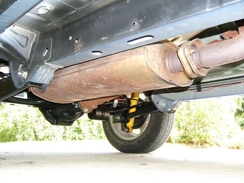

How hard would it be to install an Magnaflow or Gibson exhaust on a 2004 Liberty Sport 4x4? From what it look like underneath the car, its all bolts and hangers, anybody know if its welded at some point?

From the Cat on back is all one piece. I took mine to a muffler shop to have the muffler cut off and a Magnaflow welded in. It only cost me $100 for the muffler and labor.

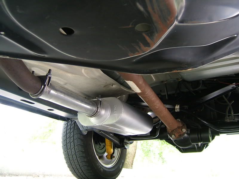

Yup, I did it myself. The extra pipe is 2.5in Inside on one end and 2.5in outside on the other. I picked it up at advance auto for close to nothing. I was thinking about getting it welded in and taking those clamps off.. I dont like how they look.

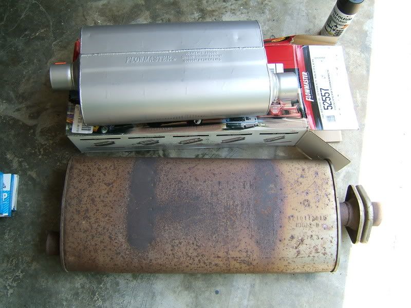

I went to a local mffler shop that specialises in after market toys cost a $160.00 for the Magnaflo installed with welding they used a sawzall to remove the old muffler I notice a little better power, no mpg improvement but it does sound sweet :!: 8)

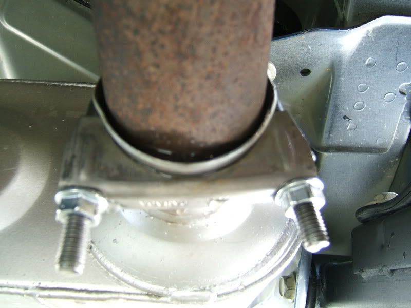

I just used a sawzall. I had it off in a matter of minutes.
The only problem I had was on the output of the muffler. It starts to turn up almost immediately after the stock muffler so it made a small gap coming out of the flowmaster. Thats another reason I want to get it welded.
I put some water around it as you can see in the pic and it didnt blow it out, so I guess there isnt a leak. :?
If you stand around and away from your KJ, you can't see the clamps. Why worry about it? Save any money for other mods or cleaning and painting supplies.
