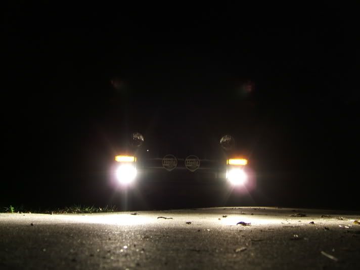

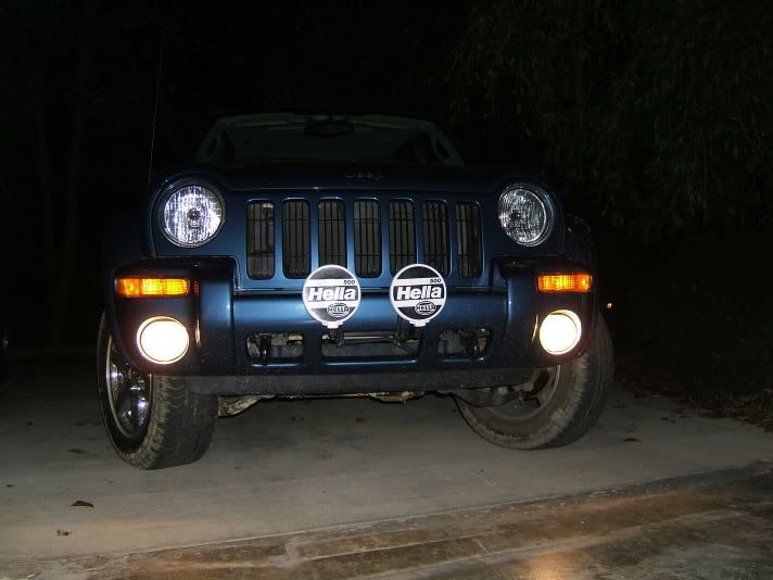

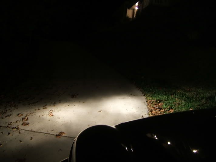

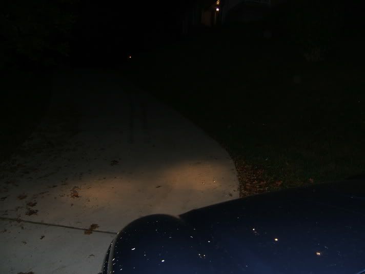

well, i was really wanting to here from some people that had done this, im afraid that its going to get to hot. Heres some pics, see if u all can tell which is before and after.
One of the lights has not been changed in these pics. Which one is it? The flash in on in the first one, but none of the others.
After:

one of the lights wasn't changed, as in left or right? or one of the pictures is of the lights before they were changed?
If it's an entire before picture, that's a HUGE difference. I wonder if there's an equivalent bulb for the 05 fogs...
Photos Cardomain
PostPosted: Mon Oct 10, 2005 8:57 pm
In the first 3 pics, one of the ligthts were not changed, i wanted u all to see if u could figure out. The pass side is the one i had changed, the last pic, the one that says after, both of them were changed. That pic does not do them justice though, look at the before pics to see the difference.
PostPosted: Mon Oct 10, 2005 9:04 pm
Posts: 1348
Location: Arlington, MA
hmm... I can't really tell any difference, unfortunately. I thought at first that the first photo was the before and the other three were the after. That would have been HUGE! But I suppose it's just a difference with the camera?
Photos Cardomain
PostPosted: Mon Oct 10, 2005 9:11 pm
lol, yea! thats first is with the flash on, ill put that up there. I can tell a difference, The right is alittle brighter than the left. The first two are where u can tell the difference.
