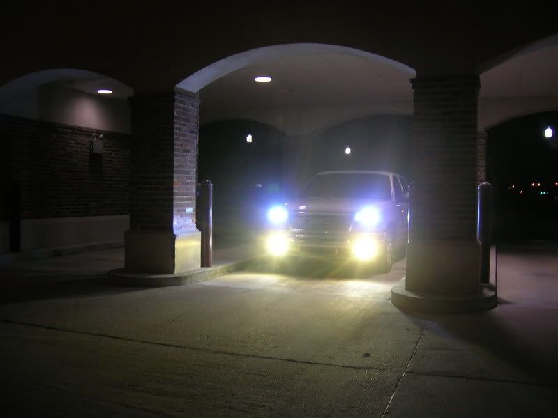

Sorry, yeah, I should have explained that. I'm using 9005 PIAA extreme white bulbs in my fog lights now, and before that I was using Silverstars.
Actually, if I had known about the amber bulb replacements before I replaced the Silverstars, I might have gone that route. It would be cool to have yellow fogs. But I sure like the extreme whites, very bright. We don't get much fog hereabouts, but sometimes in very snowy conditions I have wondered how amber lighting might help.
I've also read that Hella and Bosch make amber or yellow bulbs but I haven't been able to source them or confirm that they do.
