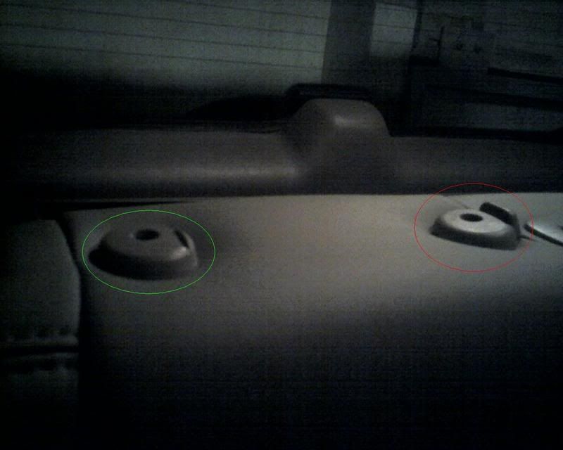

PostPosted: Fri Dec 07, 2007 10:14 am
Posts: 2548
Location: VA Beach, VA
The release latch is the smaller of the two buttons on the plastic "base" points for the headrests. I circled it in green. Just pull the headrest all the way up, depress this button, the pull up again. Should pop right out.

PostPosted: Fri Dec 07, 2007 11:46 am
Sorry about the pict quality, but hopefully you get the idea.
My 2004 doesnt have the lip on the button you circled in green. Its recessed and is kinda hard to spot/push.
I always take the head rests off when I put the seats down. Gives the driver and passenger alot more room upfront.
PostPosted: Fri Dec 07, 2007 11:49 am
Dog_party: thanks for the picture. I was always trying to use the wrong button! It worked just fine! :D
PostPosted: Fri Dec 07, 2007 6:13 pm
Posts: 2733
Location: Atlanta GA
Yes, that helps a heck of a lot. This whole time, I thought you needed to press both, which is hard to do while pulling up on the headrest (unless you have a third arm). I can do it with my knee if I'm situated right :)
