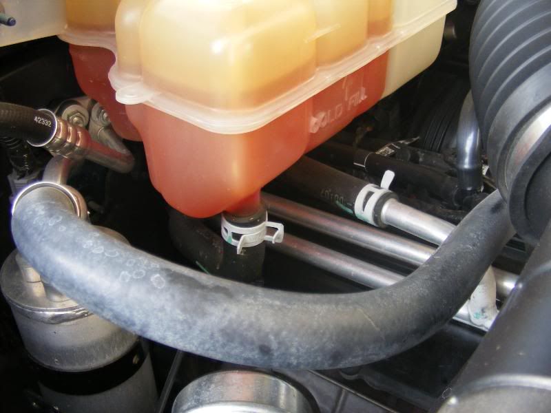

Your coolant resevoir will be on the passenger side firewall...by the windshield cowling. It should show some "orange" colored liquid and have markings where your coolant level should be Hot and Cold. Don't drive it again until you find the resevoir and you should do as directed above and take it to a shop...even if you have to tow it.

PostPosted: Tue Dec 18, 2007 11:02 pm
should look like this.
Since you only have 63k, the water pump is still under the powertrain warranty. If its not a leak then its either the rad or water pump.
