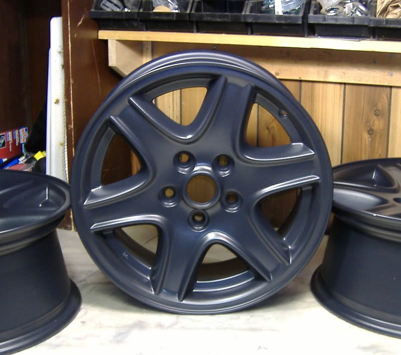

PostPosted: Sat Mar 22, 2008 9:06 pm
clean machine
clean machine
Posts: 1211
I like the Eastwood stuff. First I stripped the rims down to bare metal, sanded them with wet/dry abrasive cloth, then used a painting prep cleaner. Then the black self-etching primer and finally the satin black top coats.
No clear coats over top, and we'll see how it goes this summer. Hopefully the top coats will be enough.
The rims have been in the shed ever since though, because they're mounted with my summer tires (Grabbers). Right now I have black steelies on the KJ with studded snow tires. Those are going to be coming off soon cause it's spring! Well, the calendar says it is, anyhow.
I can hardly wait to get my summer tires back on.....
I couldn't resist mounting the rims just for this poser shot before they went into the shed..... :)

clean machine
Posts: 1211
If you mean the back of the rim, yes it is visible between the spokes. But the inside of the rim that is covered by the tire, I just painted to provide a continuous seal for the metal. Probably overkill, but I was in spray mode and just decided to keep painting. :)
I only gave the insides three coats though, and the fronts got 6 coats.
