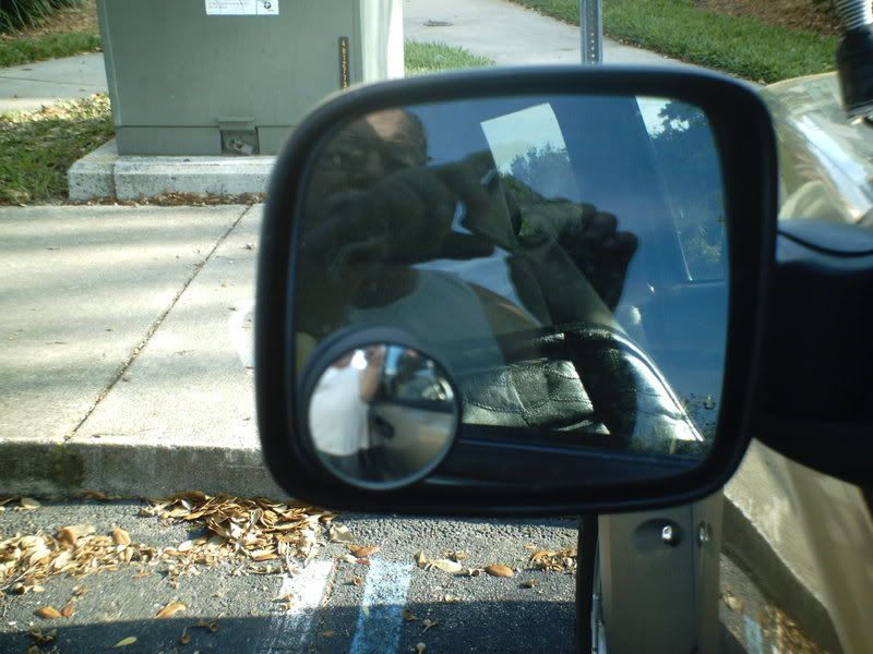

I have the round ones mounted to the outside bottom edge, work great I can watch a car all the way up to where the front end is by my door/ or passenger door, no blind spots. They are only like 2 inch I think, had the more square ones on the Cherokee but didnt like them as much.

Ditto. The 2" round mirrors mounted at the outer/lower corners. I, too, got used to having them while driving a truck, many years ago, and wouldn't be without them! :)

2" round. I put mine at the outside top of the mirror. I can't imagine going bigger than 2"...not with these little mirrors.

I put mine on the upper INSIDE. It seemed to diffuse headlight glare better in this position. PLUS I angle my side mirrors out pretty far anyway (try to see two lanes left and right of jeep). The rounds allow me to see parking spaces and other obstructions close to the body not seen by the flats.

mien are on the outside bottom corners! i love them! no looking over the shoulder anymore

i had the 2 inch round on the bottom inside corner, with no complaints. when i replaced my mirrors i got some square ones with a rounded corner. not sure of the size, but bigger than 2 inches, placed them on the bottom outside and i can see where my rear tires contact the ground! backing up has never been so much fun! :lol:

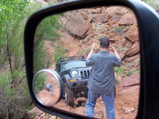

I've got mine in the same spot. Added bonus, when you're wheelin you can angle those fish eyes down and in to give you a perfect view of your rear tires..... instant spotter for those tight offroad maneuvers!

I love these mirrors. Like they said, I don't have to turn my mirrors in to see the tires, nice wider view, work great when towing my trailer and they look just fine on a Freedom Edition!
