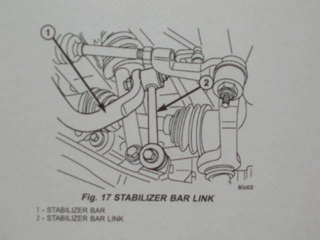

Where are you people disconnecting the sway bar?
PostPosted: Thu Apr 24, 2008 6:35 pm
I always just removed the whole thing. Remove Bottom bolt on #2 and 4 nuts from sway bar brackets and out it comes in one piece.
PostPosted: Thu Apr 24, 2008 8:18 pm
That is what I thought I would hear. It seemed to me to be the only real way to do it. At the trail I couldn't break the bolts loose so I got a guy that had upper arms the size of my thighs to tackle it. No luck there either. I did think he way going to flip the KJ though! I'll have to spray them down and let them set a couple of days and try again.
Thanks.................Terry
