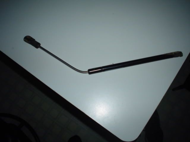

Here you go, this is to save face :P :P
I bent this getting out to the camp last night. Now I'm gonna have to upgrade the rear window suspension....maybe electric servos for window lift.
:lol: One of mine did that when a friend pushed down on the corner of the rear glass. I just bent it back and it's been working fine for over 3 years.

Joined: Wed Jan 16, 2008 11:01 pm
Posts: 103
Yeah I didn't do it, I was just informed that "something" happened to the window. I'm gonna try to bend it back for now and see what happens. I figure I can't hurt it ant worse than it is. :lol:
