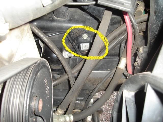

Most likely the fan not coming on,check the fan relay(10" below the battery,see pic below,circled in yellow) and the fan itself.The new style fan relay has a oversized heatsink on it since they tend to fry from to much heat.It also could be your waterpump impeller is worn and not circulating to coolant properly.
