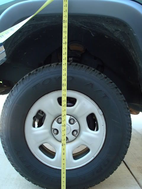

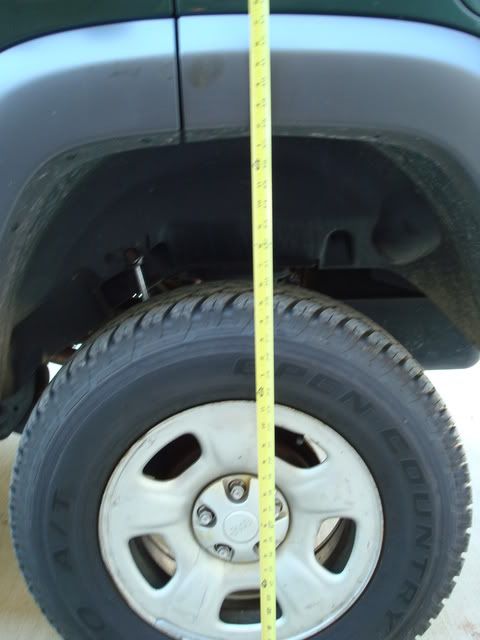

well it is an 04 and you know that it is lowered after the year 02 due to high center hieght. but yeah i does sound like your springs are sagging. how long have they been on, or are you using the stockers and the spacer? i have the rusty's with a clevis lift and here is what you get---
with the 31's
with stockers and a 245 in front
and rear
yeah, mines an 02
PostPosted: Wed Dec 10, 2008 9:53 pm
measure from the center of the hub to the bottom af the flare and let us know what that is.
If you have had the Rustys on for some time they may be sagging for sure.
Did you do a clevis when you put the springs in, that maybe a difference as well.
I would not go stacking say an OTT on a set of aftermarket springs, more trouble than what you want to deal with, already SEVERAL discussions on this already on here
