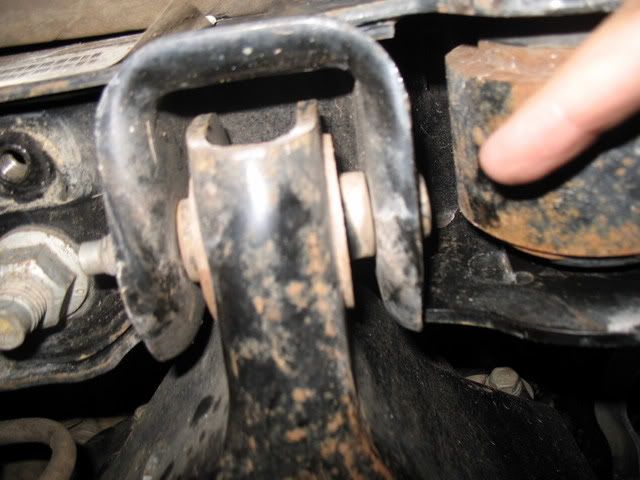

I finally got off my butt and took down the engine skid to find out what might be loose. I checked the sway bar bolts first and all seemed tight.
It didn't take long to find a VERY loose bolt which seems to be associated with the front diff. Here is the pic I took:
It seems to be a bracket that holds up the front diff. There is a single bolt shown in the picture up front and a few others that bolt to the diff on the opposite side. I tightened it as much as I could but I only had 1 19mm and an adjustable (I bought another tonight).
I took it for a test drive and the loose bolts in a coffee can sound is much reduced but not completely gone. Now that I have two good wrenches, I will torque them down better tomorrow. I was not able the get the banging noise, but that does not happen all the time anyway.
My questions now are:
Does this bracket need to come down to install the front diff?
Does this bracket require any adjustment when changing the diff fluid?
I had 1 shop do each and I was curious which one was at fault.
Has anyone had this bolt losen all by itself?
If this bolt was super-loose, do you think it could be the source of the banging?
When I pound on this bracket with my hand I still get that rattling sound but I am reserving judgment until tomorrow.

Yes to if those bolts are lose it will cause a banging sound.There is 3 brackets that hold the front diff in,make sure to check all 3 and all the bolts.The pic above is the front bracket and has 2 more bolts that hold the bracket to the diff itself.No need to remove any brackets to change the front diff oil,the front diff has a drain plug on the bottom and the fill plug is on the diff cover.

So it's more likely that it's the fault of the guys who installed the diff in the first place then. I assume that if these were torqued properly, they should not be loose.

Probably,between the 3 brackets there is 11-12 bolts.

Got a good wrench on it today and took it for a drive; no more noises! As for it running hot on the highway, thats another story.

I confirmed that this was the source of the banging. After looking at the inside of the engine skid, I could see where the diff cut through the plastic and dented the metal.
