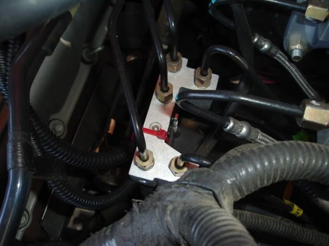

PostPosted: Thu Dec 25, 2008 2:49 pm
ObiHann wrote:
Well this makes no sense, because Im sure I have ABS. Were there 02 KJs without ABS or am I looking at brakes problem? Next question, if I don't have ABS... can I get it?
ABS was not standard on any KJ until '06,my '02 KJ does not have ABS.Easy way to tell is open your hood,look at your master cylinder,then look just a little below it and to the passenger side,if you have this(in pic below)............
Then you do not have ABS,if you have ABS there will be a big pump looking thing in place of the above pictured perportioning valve.

PostPosted: Thu Dec 25, 2008 2:53 pm
