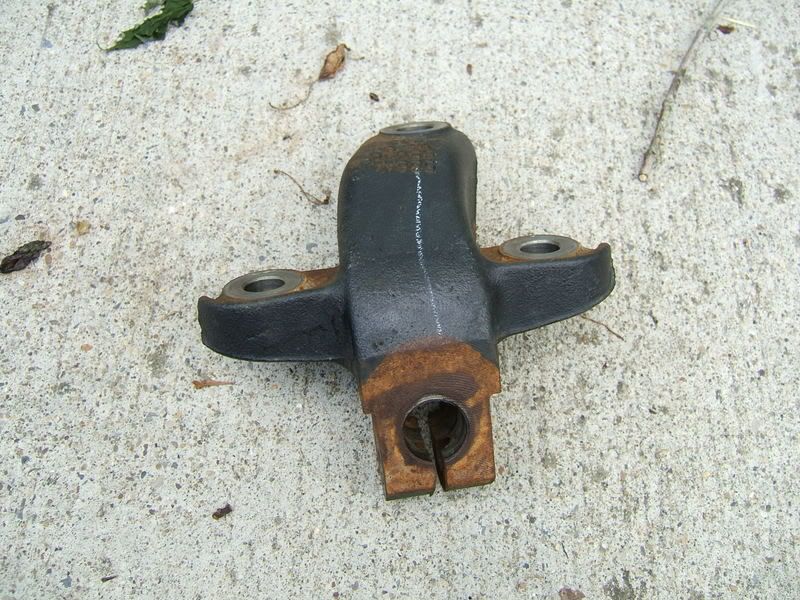

Dont need any special tools, just some sockets and wrenches. Need some big ones, I believe 21mm is the biggest, cant remember for sure though.
Taking the lower control arms off is very easy. Take two bolts for the sway bar then the two bolts out per arm and they are done.
For the upper, take the two bolts out of the frame rail and then you can either remove the three bolts(21mm i think) holding the bracket on for the ball joint or try to take the one bolt out that holds the ball joint in the diff. I took the whole axle out which made it easier to work with.
