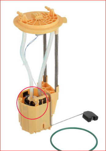

Have you installed an intank fuel pump?
If you do not have an intank pump; the suction hose inside the fuel tank module more than likely has a hole in it or has broken. It is a hard plastic tube. See picture of OEM tank module below.
If you are going to drop your fuel tank to replace it, it would be an excellent opportunity to install an intank fuel pump as many owners have already done. It is a drop in fix in place of the OEM unit. The only difference is one has an electric lift pump in the module.
See this thread for information on installing the intank fuel module with pump:> viewtopic.php?f=5&t=26385
Picture of OEM fuel module inside fuel tank. -----------------------Picture of intank fuel pump module.

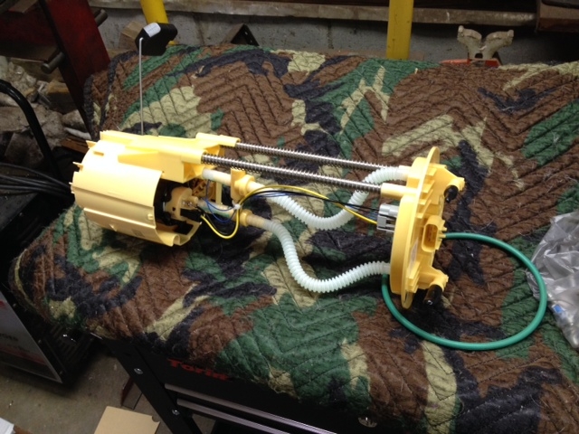

 Post subject: Re: Out of fuel at 1/4 tank - PROBLEM SOLVED
PostPosted: Wed Feb 24, 2021 1:50 pm
Joined: Wed Nov 25, 2020 8:44 am
Posts: 29
I've been meaning to get back here for a while and post for other peoples benefit. I dropped the tank on my CRD and removed the fuel pickup. I was shocked to find that the rods and springs that connect the top of the sender to the bottom, were just laying on the bottom of the fuel tank. The bottom portion of the pickup was swinging around like a pendulum from the pickup hoses. When I would stop at a light, I would hear a a clunk, clunk, clunk. I now realize that I was hearing, was the bottom of the pickup banging around as the fuel swished back and forth. I have no idea how this could come loose. Especially considering that when you install it there is spring pressure holding the bottom in place, and the bottom of the tank is molded to seat the fuel pickup. I've included a pic of the new pickup next to the old one to show what it should look like. I replaced the old pickup with Sasquach Cummins In-Tank Lift Pump for Retrofit. I debated for a while because when you include the wiring harness its nearly 3 times what a simple fuel pickup would be. But now that its done I'm confident I did the right thing. Plus, priming the system is now a breeze. Turn on the key, open the bleed valve at the filter and wait for fuel to spit out.

 Post subject: Re: Out of fuel at 1/4 tank - 4 gallons left in tank.
PostPosted: Wed Feb 24, 2021 1:58 pm
Posts: 7381
Gosh that is ugly indeed!!! :shock: :shock:
I can't imagine how that could have happened. First I have ever seen of this.
You certainly did the right thing, adding an intank lift pump is one of the very best mods you can do to this vehicle. :BANANA:
