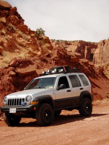

Bedlined and painted grill, Fenders, bumpers, and beltline.

IT IS NOT A POWER RANGER! :D At the 2008 LOST Moab Safari we had a memorial run for a member of this board who passed. Matt always had an intel bunny with him, so we all threw on our KJ's and did a run in remembrance.

No I left it on. Tapesd off the top of the beltline, sanded and cleaned the area, hit the corners and crannies (like at the molding) with a brush, and then rolled the rest out.
