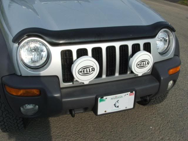

I too was nervous of where to drill into my bumper to mount my lights so I came up with this idea.
I managed to mount a piece of aluminum square tubing on my front clip by passing the fastening bolts through the grill slots.
Its more of a temporary setup, an experiment. They really don't bounce about but I've since learned that they're too low, they don't shine far enough down the highway. But all I need to do is raise them a bit. By the way those are a pair of Hella700FF's.
If you'd like I can post more pics of the construction.

LibertyFever wrote:

The comment on the foglamps regarding placement, yes the lower the better and to remain legal they should be wired to the low beam only.
I don't quite understand why they'd be 100W, maybe they really aren't foglamps but rather driving or spotlamps.

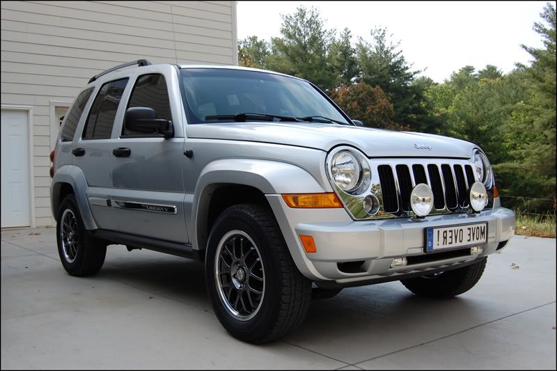

So was I, so I did this...
I welded a washer to the u-bracket and 3m taped it to the bumper. It is fairly sturdy. The lights only shake when you hit a good bump. Kinda only works on painted bumpers, though.

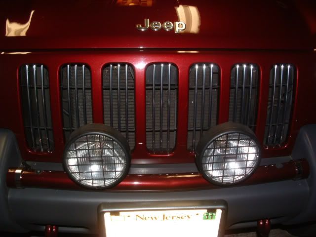

Make yourself a bar, and mount them like this , looks much better and stronger than drilling thru the Facia.
How does one go about making a bar like that if one does not have a welder or a tubing bender? Someone on here made one similar to that but I can't remember who...I wanted to buy it off that person but they changed their mind at the last minute.

Prospect62 wrote:
Anyone want to make me one?
You dont need a tube bender or a welder, all you need is your local Electrician, that was made out of 2.5 Dia, Electrical Conduit, Electricians carry a special box it looks like a tool box usually about 4' long depending on the jobs they do, the PVC conduit is placed inside this box, its heated and they can bend it at almost a 90 degree angle. It took my Electrical guy a whole 10 minutes to bend it.By the way, if you decide to try it Do Not use standard PVC pipe, will not work.
