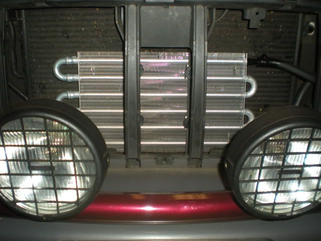

I have an 02 with a 45 and the cooler in the radiator, but last year I decidied for a bit more when pulling my trailer so I added this one. I attached it to the front supports.
