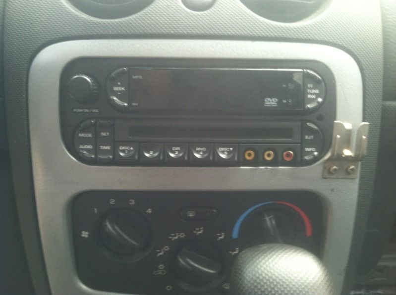

if you are wanting an OEM with and AUX input you can try and find a REV head unit out of a 05-07 town and country
and chrysler pacifica
but if you get one out of the pacifica you are going to have to do some trimming
here is my DVD build with that unit
http://www.lostjeeps.com/forum/phpBB3/viewtopic.php?f=45&t=66258
edit this is what the REV looks like in the KJ
