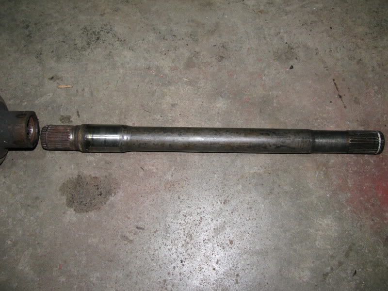

Some times the intermediate comes out with the CV if not then its just a matter of pulling it straight out, may have to sort of pop it out since there is a ring holding it . But 2 hours to do just the CV? wow!Passenger side is easier than the drivers I think.
This is waht the CV and intermediate shaft look like out, these are my old ones
better picture of the intermediate
here you can see the clips on the end ( bad picture but you get the point)
