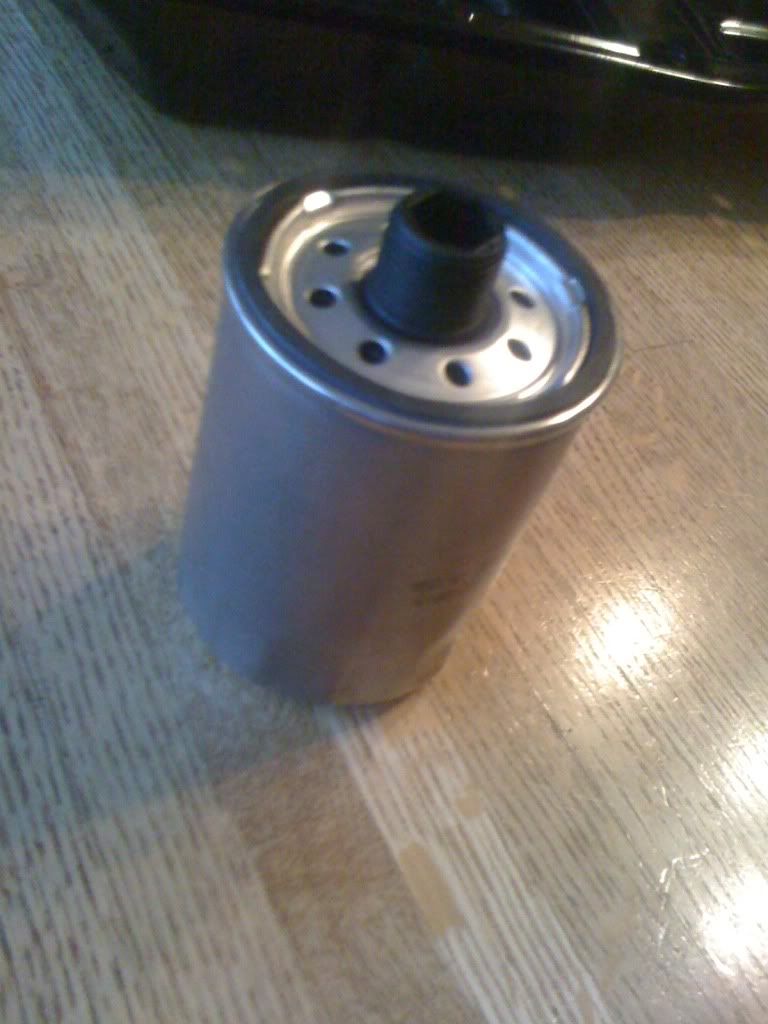

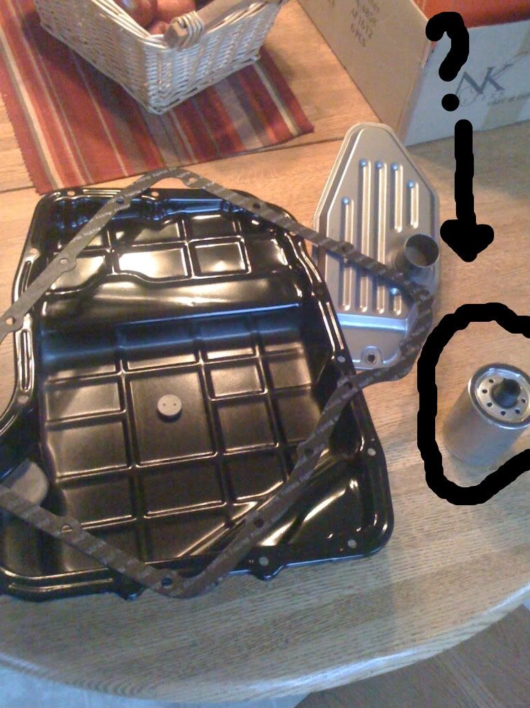

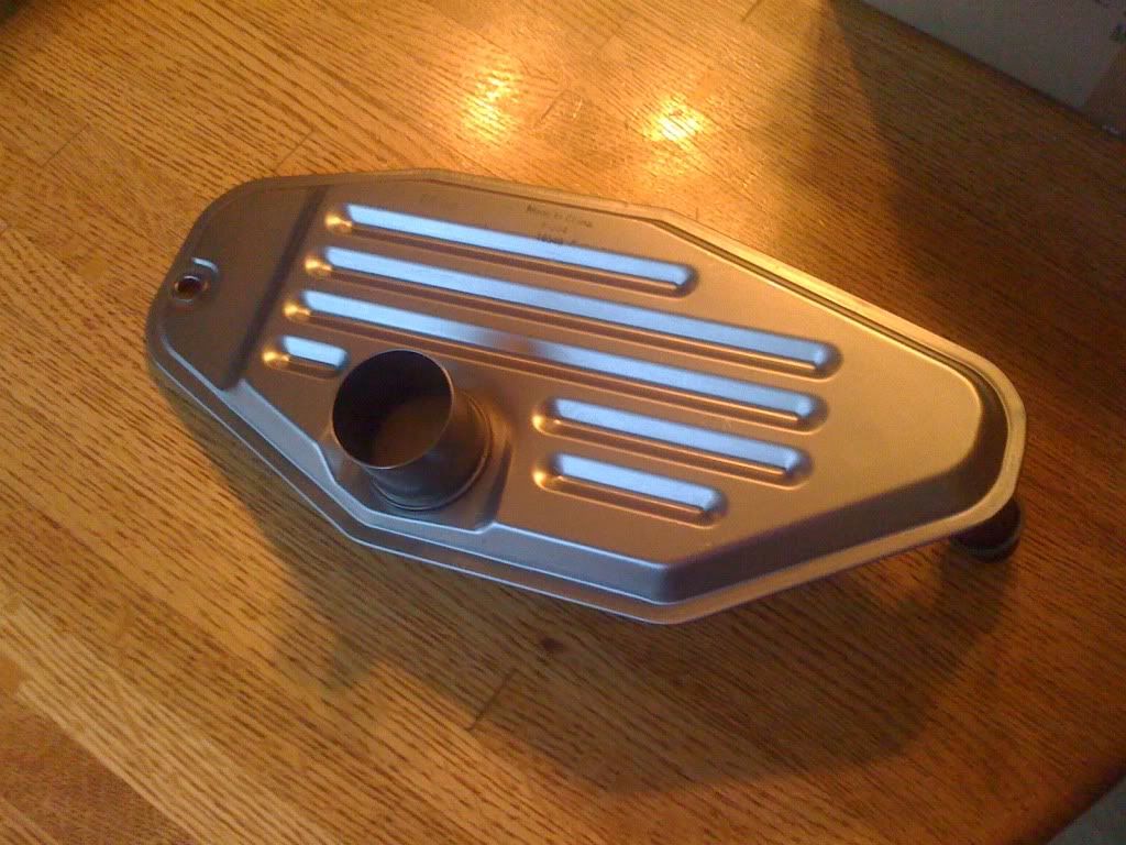

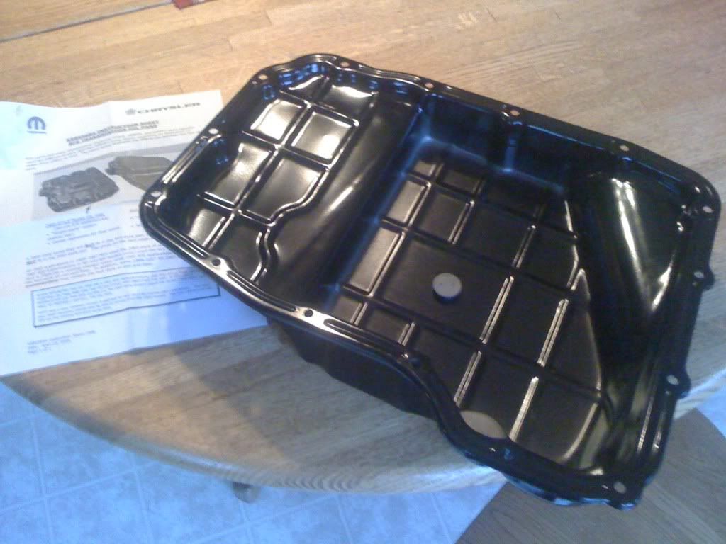

I just got a new trans pan because mine got rusted through.
Ive got just got a couple questions. They are above the few pictures below.
New Trans Pan
Pan
Filter
Is this the right kind of transmission oil? (its synthetic)
What is that used for on the trans??
Hope you can help

I don't know about the fluid, but that is a second filter.......
 Post subject: Re: New Trans Pan...2 Questions
PostPosted: Mon Mar 22, 2010 9:56 pm
The 45rfe on the 2002 libertys has two filters. One is a spin on and the other is a sump filter. Once you get the pan off you'll see whats going on.
Idk about that fluid, Ive never heard of it. Id stick with a name brand ATF+4 fluid.

thanks for the help.
the oil just came with the filters.
the pan is mopar but the filters are not. hopefully the oil and filters will be okay.
