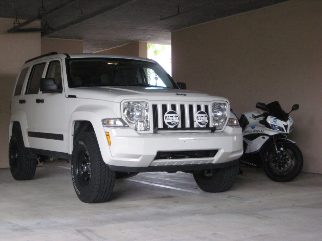

PostPosted: Wed Mar 24, 2010 1:46 am
Here is one on a KK
Wnahikian wrote:
