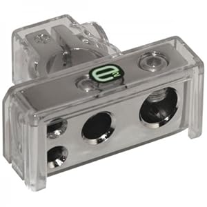

I bought this one from amazon so I could dress up all the wiring from my lights, amp and soon compressor.

If you went the marine style route, you need something like this on the end of the cable for attachment... big ring end terminal, you maybe familiar with smaller crimp type one. Yes, you maybe able to crimp yourself. I've done it using a vise, or even a large chisel type pointed punch, but then you may have to remove cable.
That last pic is sweet, nice terminal... how much did that cost Sport?
Cheap 10 bucks and free shipping.
http://www.amazon.com/Scosche-EBT-Batte ... 536&sr=8-1
Amazon has others too, search battery terminal
