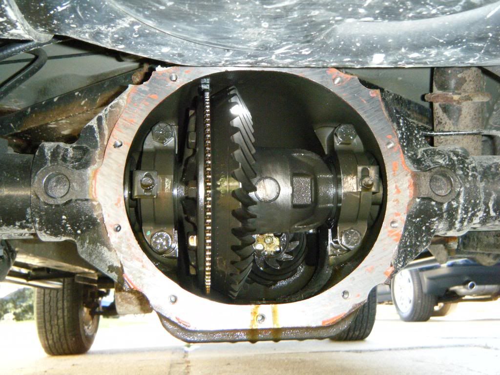

I've gained so much information concerning my Jeep Liberty tolling this, and one other forum, it's amazing how much I did not know about this vehicle until recently.
Just the other day I happened on a thread that discussed changing the differential oil in the axles, and it indicated it should be done about every 15,000 miles...... :shock: ......I'm approaching 30,000 miles and never gave it a thought, so this afternoon I pulled my home made skid plate off the front, and dumped the old oil out, and man did it look like it needed changing too.....
The front was easy, drain plug on the bottom, fill plug approx half way up the housing, drained the old, pumped in the new....then off to the back axle....and this is where things got weird.....
The manual says that both front and rear axles have the two plug arrangement, the front has it, the rear does not...no drain plug....????
and the filler plug is a rubber bung, not even a threaded plug.....WTF.....????
I had to unbolt the cover to drain the oil, I've done this on vehicles ranging from Toyota pickups to military surplus M-35's, and I've never seen an axle that didn't have a drain plug / filler plug combination.....
If that isn't weird enough, no gasket......WTF...again.....???
This cover was sealed on with RTV sealant, and thank God I had some in my shop or I would of been screwed until tomorrow morning when the hardware store opens....(actually I always try to keep a tube of it around for such emergencies).....
The silver lining around this cloud was, it gave me the chance to check for metal shavings on the magnet, found some minor...(to be expected)...crumbs stuck to it, wiped it out as clean as I could, resealed the cover with fresh RTV sealant, bolted it back together, and pumped in fresh gear oil.....

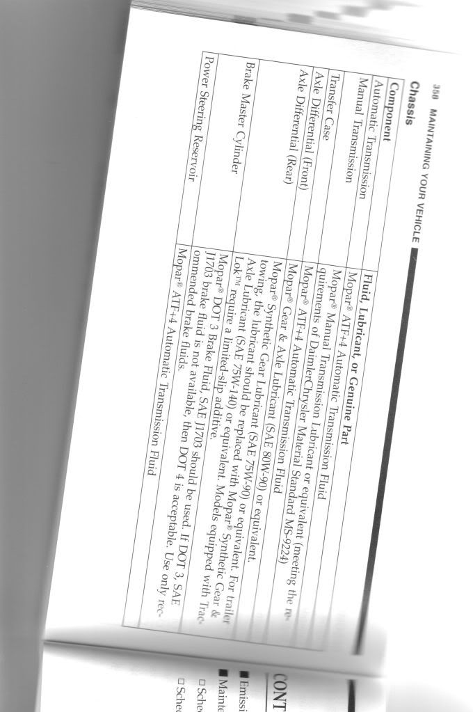

RED_KJ_666 wrote:
Front should be 75-140W Full Syn. Arguably the rear should be too. As far as I know the owners manual in the dash says 75-140 for the front for all kj's 03 and newer, and also states if towing with the vehicle use the 75-140 out back as well.
Straight out of "my" owner's manual....
Front axle - SAE 80W-90 or equivalent
Rear axle - SAE 75W-90 or equivalent...unless I'm towing (which I'm not) then SAE 75W-140
Don't believe me, read it for yourself.....
Rear axle - SAE 75W-90 or equivalent...unless I'm towing (which I'm not) then SAE 75W-140.
You are correct in that the manual does recommend full synthetic, so I may change it again to that, I had the Mobile Dino oil on hand, so that's what I used. Sorry guys but I can't imagine I'm doing any damage by using the Dino oil, and according to my manual the viscosity is right on for the rear, and close enough for the front with 75W-90.......
My 2005 specifies the same viscosities as yours.
75W-90 is a fine substitute for 80W-90, it just means the 75 stuff flows a little better at cold temps. Less like honey. At operating temp they are both a 90 wt gear oil.
