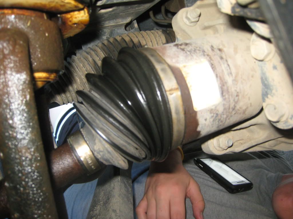

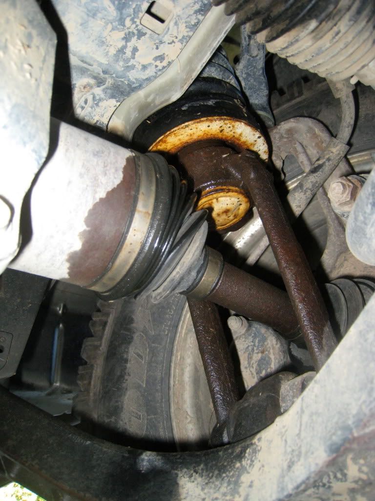

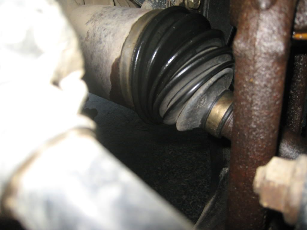

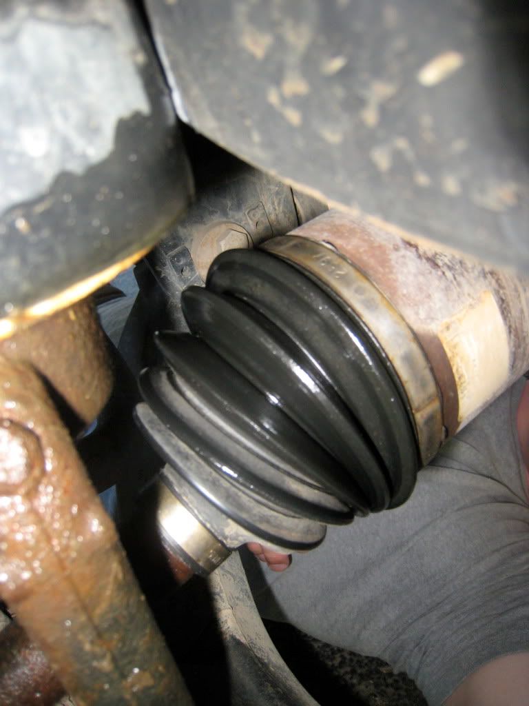

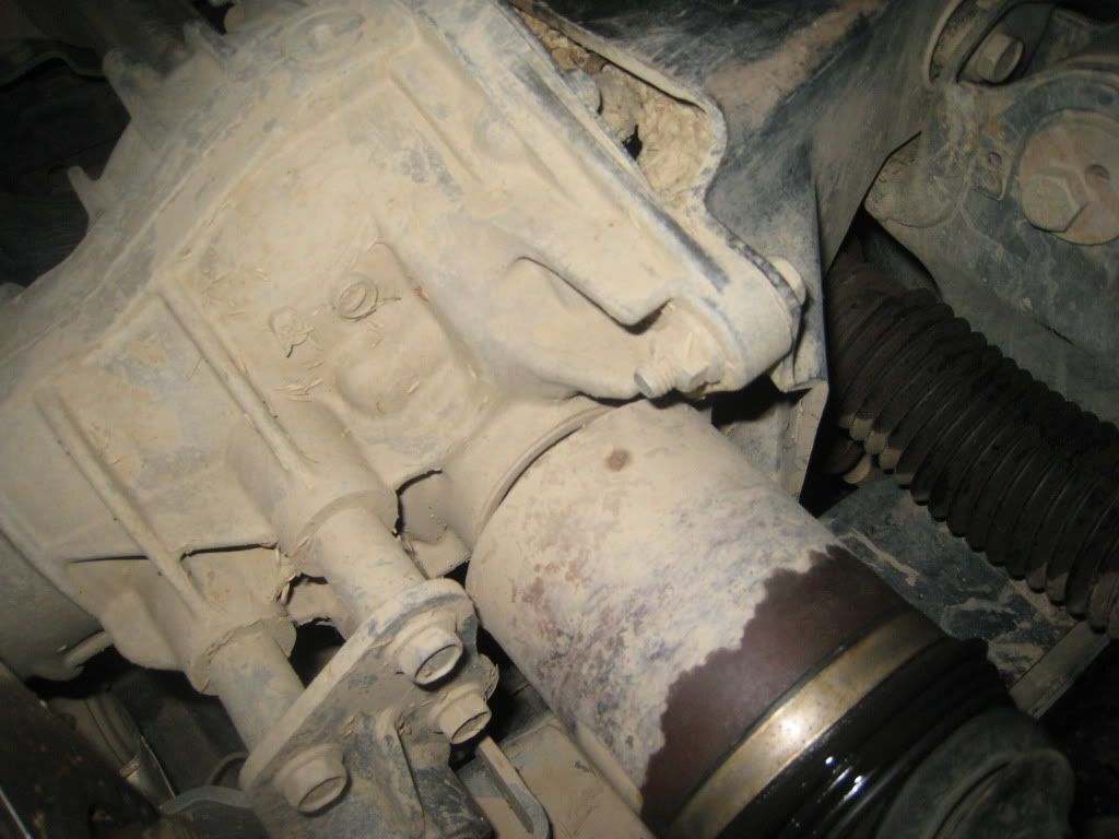

Ok, so I have been talking to Teckman for over a month about this problem I am having and just recently talked to ihatemybike and came up with two possibilities.
Either my driver side cv is toast and I need to replace it or my axle seal is bad and I need to fix my clamp on my boot on the cv.
take a look at my photos and see if any of you guys know whats going on here :)
and yes, i took pictures of all the stuff that has been getting soaked in what ever fluid that is for the past month.

I would replace that leaking shock 1st,from the views of the pics.

Yep shock, CV grease you could tell right away
