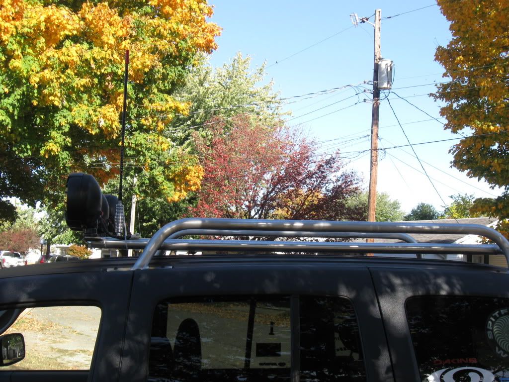

LI_KJ here you go (its alittle dark)
we bumped the lights out about 7 inches from the front of the rack, where normally he would have the light tabs. He took a measure of the lights that I was going to use gave an little more than an inch clearence to the back incase I ever switch lights. On the main part of the rack he measure for mounting points for the snowboard rack by measureing where the bindings would be in comparison with the snowboard rack. Once that measurement was checked out he then welded mounting points onto the rack to bolt down my snowboard rack.
I will see if I cant get some more photos this evening.

Totally would like to see how the snowboard accessory mounts to the rack. Is the Thule rack you have the clamp type http://www.thule.com/en/US/Products/Sno ... 20Top.aspx
Or is it like the upright style? http://www.thule.com/en/US/Products/Sno ... rrier.aspx
I've got a flat top clamp style with round bar mounts. And the bike trays also use the round mount sound imagine I need a different design.

Its the clamp type. I did have to make one concession with this project. With the clamp type using the complete Thule rack system (feet, crossrails, and clamps) you can mount 4 snowboards (base to base). With my new rack I can still do that BUT I would have to take the bindings off of two of the snowboards (the ones facing down).
Its raining today but hopefully when I get home from work it stops of lightens up. Either way I will get some more pics up!

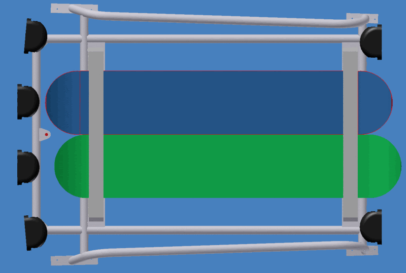

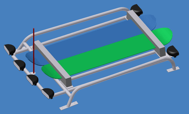

instead of pics I found the actual CAD drawings from Boiler, this should give you a better idea......

I think I found my BOILER rack.. That's pretty much exactly what I want..
You can always get a cheap pair of Cross Rails to mount to the top of the rack, so you can mount 4 boards and bindings. (Amazon has a pair for $40.)
How tall are the top of the lights to the roof line?
Also, if you have any other pictures! thanks!! 8)
