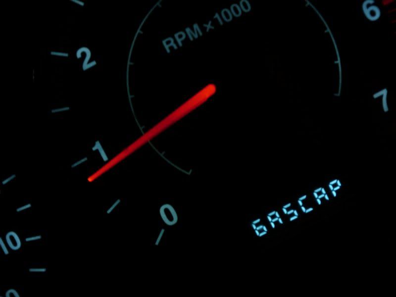

So I removed and tightened the gas cap, unplugged the battery to reset the system. I had no issues, then about three days later I start my Jeep after it sitting for about 6 hours or so, after two fifty (50) mile trips, for a total of one hundred (100) miles. I instantly get a message come up, not the Check Engine Light, which surprised me, in the odometer space, where it usually tells you if the gate or glass is open, I get a "GASCAP" message.
So, I take it off, put it back on tightly, restart my truck and go on my way. Today about three days after the gascap, message my CEL come back on, I haven't gotten a chance to check the code, but I'm assuming it is related.

Sooooooo, I bought my 10.99 gas cap from Autozone.
Tonight, at 1:00am, I start my truck, begin to take off, and "BING BING BING" .. I get the GASCAP message again.
Any ideas?? Starting to get worried. :?
