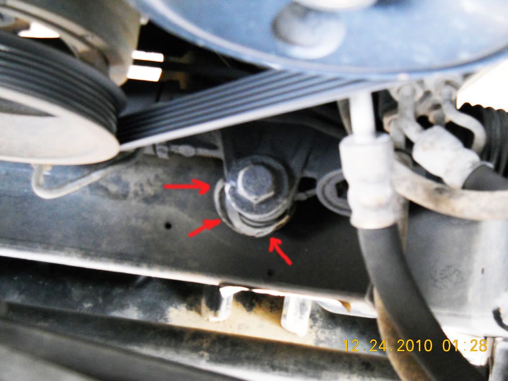

Also noticed torn rubber around the power steering mount (the one where the end of the oil filter is pointing at - I think that is a good reference point). The rubber is torn and sticking out of the mount.

As for the torn rubber. See arrows in picture. It looks like it is coming from directly below the washer and not in the middle. I couldn't notice any rubber on the other mount. Is there supposed to be a rubber grommet/washer/disc located there?
