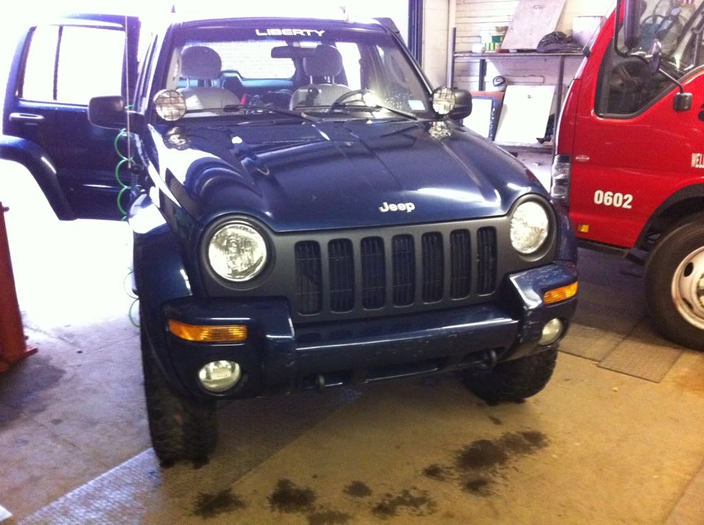

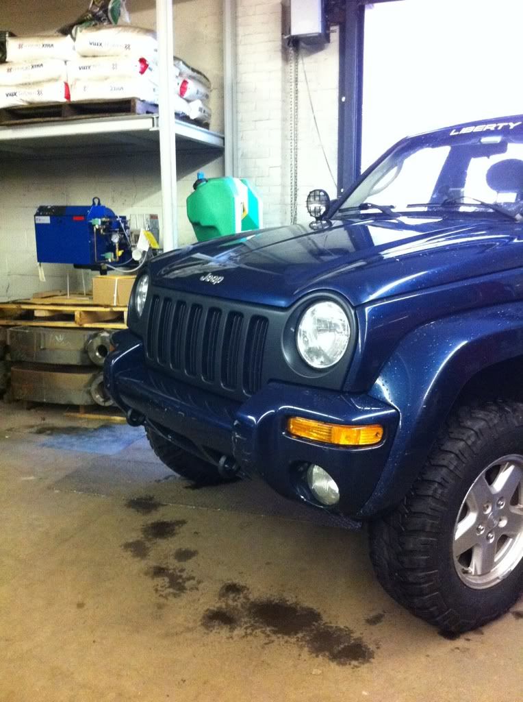

Recently just painted the whole piece that goes with the grill, (around the headlights and etc) a flat black

 Post subject: Re: Painting grill
PostPosted: Mon Aug 29, 2011 4:11 pm
Joined: Mon Oct 18, 2010 4:16 pm
Posts: 37
Pics please :)

I think it would look better if my bumper paint wasnt chipped to doo doo from all the wheeling.
PostPosted: Mon Aug 29, 2011 10:50 pm
Posts: 587
Location: Trenton, MO
Looks really good. I like it. Did you just spray it down or what? I wonder sometimes what the longterm is gonna look like on mine. I'm afraid mines gonna start chipping or peeling.

Very nice! I'm going to bedline mine one day. Just need to get off my tail and do it...
That looks really good! Is it just flat black? Any clear coat? Probably going to do this when I'm making my new bumper. :JEEPIN:

Thanks, its just a bedliner, rustoleum brand actually. I just sprayed it down, couple coats. Paint took to it well.
really?? I would have never guessed that was bedliner! I believe I used the dupli color on my belt line, looks like mine has a little bit more texture but it might just be the picture.

yeah, it has very small whatever they put in bed liner so it has a nice looked, put it on my skink sliders as well
