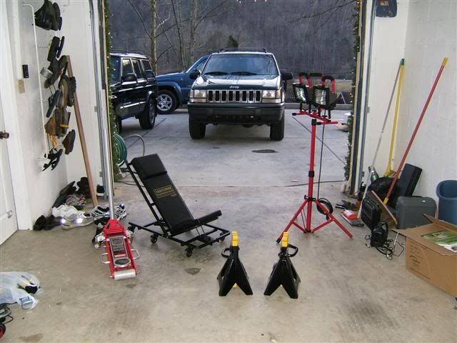

No, ive never lifted a lifted libby, but heres some pics of it. ohh, and i found my jack, it says it lifts up to 18 1/2in, so it goes high enough.
