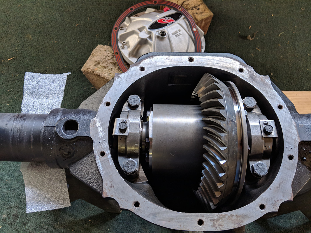

I'm a hobbyist machinists and auto mechanic, I rebuild motors, rear ends and all transmissions, learned this putting myself through school. My scanner works fine for me. As employment I am a software and electrical engineer. What you need is not what I need. Thanks for your input.
Just finished a junk yard donor rebuild for my jeep, added a trutrac LSD. Just donking around for fun, my day job is stressful.
17 in/lbs pinion preload, .0065 backlash, timken bearings, factory pinion nut, yukon pinion seals, new wheel bearings, seals and yukon axles.

Looks good, I am planning to add the truetracs front and rear to my wife's when I swap in some 3.55 axles, the torsion difs work way better than any clutch pack, I frequently rebuild the clutch packs or replace them with a power trax locker, I always tell guys one trip up the boat ramp and the clutches can be fried, that's why I hate clutch style LSD.
