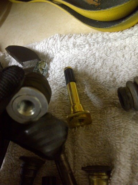

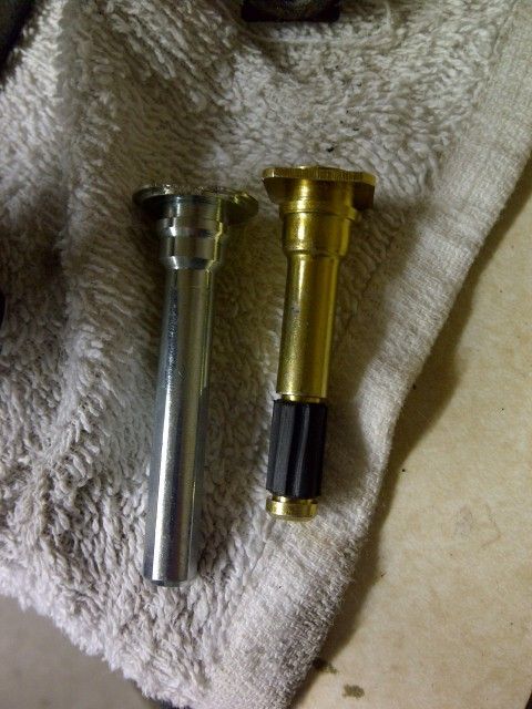

Thanks for the replies. Currently in the garage cleaning the caliper brackets and replacing the slide pins. Can anyone right off the top of their head verify which slide pin goes in the top and which goes in the bottom? The square headed slide pin was in the top when I took them off but I wanted to verify. The gold colored pin with the rubber on it is the one that was locked up. Took the biggest pair of channel locks I have and all I've got to pull them out. Not sure what was wrong with the old ones... Ill post a pic later...

Take the rubber sleeve off the top slider pin and throw it away. They are known to swell up and prevent the caliper from sliding properly. Just lubricate the slider really well with caliper grease.

So the one with the rubber sleeve goes on the top? That's how I put it back together.
I've thought seriously about taking that rubber sleeve off. If these new ones don't work out I may do that. I don't understand why they made the top ine with the rubber around it like that though?? What's the point? I found new pins at advance for $16. Came with new bolts for the calipers too.

Lostkjs sure makes it more complicated to upload photos.. Maybe Im missing something.. Either way, here are a couple pics of the sliders in case someone doesn't understand what this thread is about... Brakes have been bleed thoroughly and new pins have been put in the front caliper brackets and greased with synthetic caliper grease. Well see how they do going to work in the morning!
