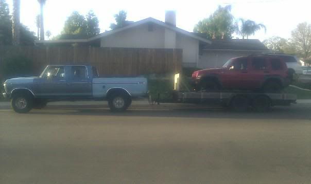

it turns out that the brand new clutch bearing I bought from napa less than a year ago burned up and melted the clutch and probably the compressor too. Also the 66" belt was not even close to fitting, so that info from the other thread was wrong. So I had to remove the clutch from the compressor and had to buy the 82" belt and bypass the whole A/C compressor altogether. I got the Jeep running so I could drive it up on the trailer and tow the whole family home. I know the compressors are spendy and im not looking forward to spending close to $500 bucks for a new one. Anybody know where to find one for cheap, other than a parts yard?
If anybody wants to know.... the belt that worked for me was from O'Reily's and it was a micro-v belt part # K060815
