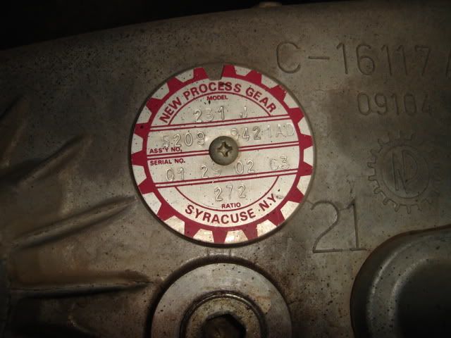

The shifter is the easiest way,4 spots and it's the command trac,5 spots and it's the select trac.The KK's have a small switch in the center console and do not use NV/NP t-cases anymore but MP t-cases.There is a tag on the t-case also that tells which case it is.
